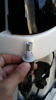

I bought a pair of these on Ebay from a US seller.
2X Super Bright CREE R5 9W Backup Reverse Light Bulb T10 T15 912 921 | eBay
I haven't installed them, but did complete a full LED interior and license plate light replacements and man, what a difference it makes. The Cree LED's are super bright. I'm pretty sure they won't disappoint. I'll try to install today and upload pics later on.

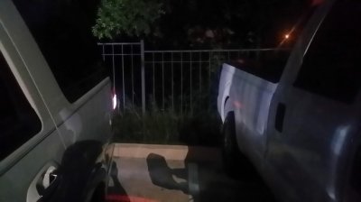

Check out the attached pictures. I was not backed up to a wall, but rather a fence. As you can see, i did not apply any filters to my camera, and the one with No Light shows nothing in the background. The one with Light on shows the fence line, trees and the car next to mine. And that was just that driver side bulb. These are bright and only cost about $12. Get em', you wont regret it.
