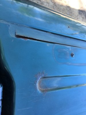

I have some rust begining under the molding running the length of the truck. It looks to be surface rust only, I wire wheeled it and spray with rust converter. The truck will have a roof basket so for additional protection/prevention I will be using roll on bed liner.
Question - Is that molding glued? Whats under it? Should I just remove and bed liner it?IMG_2634.JPG IMG_2634.JPG IMG_2635.JPG

Couldn't tell you about the moulding, I just filled in the divit above the overhead console with the 2 flip down sunglass holders. Why not shoot over to dealer and see if either they can print that pic, or the guys in the body shop could tell you!
