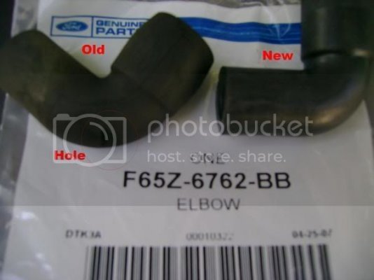

I would like to thank Lane24 for the valuable information on that hose.
My 2003 Expediton started missing and had a rough idle and stalled a couple of times.
Took it to Autozone and had them hook up their obd reader. Codes po171, po174, p2195, and p2197 popped up on the reader.
I cleaned the MAF and had no change. Put in fuel injecter cleaner and had no change.
Looked on this site and found Lane24's thread. It took a little while to find the damaged elbow but shure nuff that was the problem. Thanks again

Lane24, thanks for the vacuum leak heads up. Found a cracked rubber connector between the pcv and the heated air inlet adaptor (i think) on the passenger side of my throttle body, and replaced it with a 2" section of 3/8" id radiator outlet hose i had floating around...i'll let you know how that works. Found this thread searching codes P9600 & P9602. Have been getting P0171 & P0174 for awhile. More backstory: Got a P0305 & P0316 this morning before I found the vacuum leak. Going to run it now & see what codes I still have. 156K on the motor and 15K on the fuel filter. All plugs changed about 125K.
Wouldn't have found that vacuum leak, even though it was right in front of me, without your photos, etc. Lane24. Thanks! Stay tuned....
gwinnch
Sep 9, 2007
Houston, TX
Started right up this morning (had been hard to start) and has not thrown any codes after being started & stopped 4 times. Thanks again.

Lane24
technical advisor
Dec 4, 2006
1,896
149
Alberta , Canada
I Don't think everyone is saying IAC, just one guy. I think we are saying PCV hose. IAC is common thing for shops to tell you who don't know about the 'elbow problem' . Yeah, I think the first thing most of us does is clean their MAF. I clean my MAF, or mas as you call it whenever I change my oil. It is talked about quite often in other threads related to these codes. But thanks for mentioning it here. Someone will def. make use of the info.
