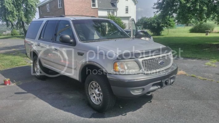

yeah.. mines pretty bad.. i bought it for 3 grand. took it home. on the same day i got under to change the oil and just looked up and saw the radiator and ac condenser just dented and laying on the frame.. took the front bumper off and then shit myself. the only rust that i found thats bad is the radiator support, brake lines, trans lines, power steering lines. and the shock absorbers are rusted pretty bad. but i bought all that stuff to be replaced. should be all coming within the next week or 2.

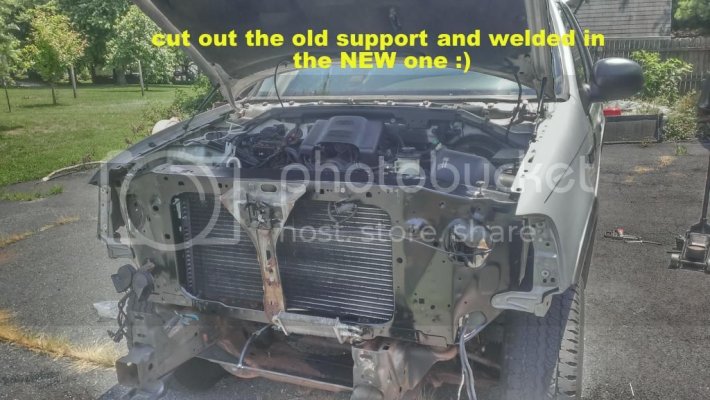

just an update. got the new radiator support in place and welded in. and the front end put back together. it all lined up pretty well. the eco version of the radiator support fit very well. there were some spots that i had to sorta bend to fit right. like at the sides that slid into the body metal thats folded over but over all .. was pretty simple.

so the next couple days. just working on the rocker panels. already plasma cut the old ones out.. just have to weld in new metal. and then all i should have left to do is
repair door rust
replace windshield
replace brakes and rotors
vac and recharge the ac system. ( installed new setup.)
