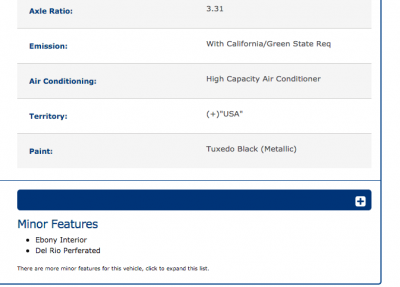

Thanks for the link. That is where I have been going. I don't know if the site doesn't like Macintosh's and maybe it only works on Windows machines, but once I enter the VIN, it pulls up a 2 column Vehicle Summary page. On the top right, it gives me a list of Primary Features and then under that is Minor Features and it only list the interior color. Below it it says to click to get more features, but when I click on the plus, it doesn't do anything. If you want to try it to see if it's a MAC/PC thing, I would appreciate it. We don't own a PC to try. My vin is 1FMJU1JT7FEF07038. This is a sreenshot of what I see when I try to look at it.Screen Shot 2017-09-12 at 11.58.54 AM.png

I was unable to get the build sheet until I registered as an independent repairer. Then I was able to get this:

I was able to find a website that gave me this. So it does appear that I do have the Heavy Duty Trailer option, but do not have the Load Leveling Suspension.
