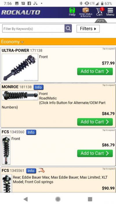

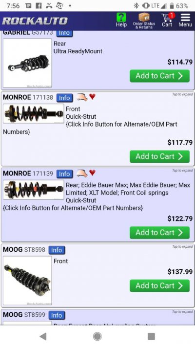

As you can see in the pics, Monroe sells the roadmatic quickstruts for a decent amount less than the others but I have heard they are not very good at all.
