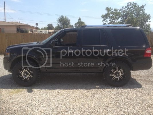

Readylift is going to be your best quality spacer kit. Most expensive at $250.
If you are wanting to just level the front I would go with Bilstein 5110 adjustable front struts from an F150.
I am going to run Bilsteins up front lifting it 2” and readylift rear spacers lifting the rear 2”.
Pretty much all trucks have a bit of a rake to them for towing purposes.
Leveling the front is not going to cause you any issues in handling or mess with your roll systems. Now the California lean I think they call it, front noticeably higher than the rear, will.
I can’t even see the rake on these Expeditions it is so minimal. I measured it and it is there but I can’t tell with just my eyes.
You want a noticeable factory rake my 2000 Silverado Z71 is very very noticeable. This rides on Bilstein 4600s no lift no level and the rake is always apparent. Though she is soon to get Fox Shocks and a more aggressive tire.
She cleans up quite nicely for 19 years old.
