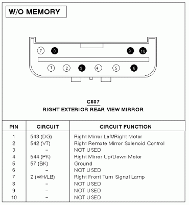

Correction There is a difference in the connector wiring depending if the mirrors have signal function or are memory function
The connectors are the same physical size but the wiring is different
Prints shown are for the passenger side Drivers side would be similar

Thanks alot just what i needed to know, mine have memory but as long as the new ones are heated and power is all that matters to me.
Thanks again for providing these diagrams
