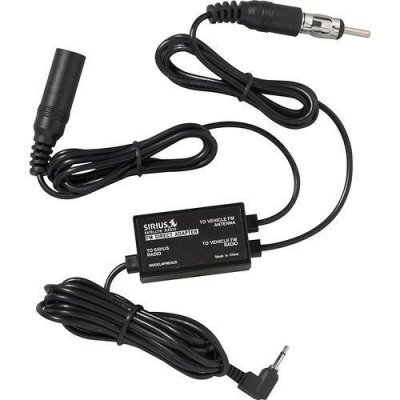

Pick up the Sirius FMDA25 when you buy your satellite tuner. It's an FM direct wiring "harness" that basically injects the satellite radio audio into the FM of the factory stereo.
You'll choose the fm station of your choice on the Sirius unit. You can change this as needed if you travel to pick one that has nothing else on it to minimize inference.

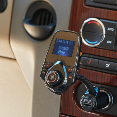

The AUX jack is on the side of it. Also has a volume control and you can set the FM channel to your choosing. NSAA.
