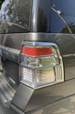

I’ve done this same upgrade about six months ago. I also did the taillights as well. Overall I am pleased with how bright they are. As far as anyone say they aren’t Legal in every state they are wrong, they are OEM and DOT certified. If color is a problem they also have a red plastic version of this same light3A8ED1FF-EFDF-4A65-983D-9A9DC5F82AB5.jpeg 141FAB72-4CCE-4A05-A0BC-11659CFB4A82.jpeg

I’ve done this same upgrade about six months ago. I also did the taillights as well. Overall I am pleased with how bright they are. As far as anyone say they aren’t Legal in every state they are wrong, they are OEM and DOT certified. If color is a problem they also have a red plastic version of this same lightView attachment 32345 View attachment 32346
Which brand taillights are those?
