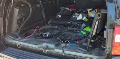

Well, I do have the tow option. The test was successfully done. I knew the front 12v socket didn't have any shut-off but I wasn't sure if the rear was the same. I plugged in my controller and panel, left it for a few hours, came back to it and checked the battery voltage. My little V monitor in the front said 12.8v while the charge controller was saying it was charging at 14.7v. To me, this does not seem correct. But my battery WAS being charged so I'm happy. Now I just need to build a new floor and drawer system for the rear 40 split. 20190822_162449.jpg

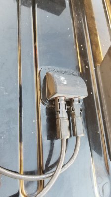

So I did a thing again. I pulled the rear side panels and even the subwoofer looking for a nice spot for my solar charge controller. I ended up putting the controller on the floor next to the blower motor for the rear a/c. Mounted the mc4 connector, drilled a little 3/8 hole, blasted that with some spray paint, put a grommet, routed the wires, put sealer under the connector housing, pressed the housing onto the roof, gave some sealer along the edges, let it sit, then popped a little spray paint over the sealer.
Pretty decent area under the floor for me to do some work with a sliding floor. I bought a nutsert tool. I'll be having fun with it soon.
