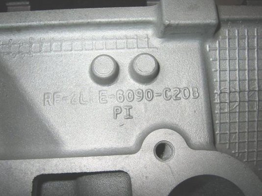

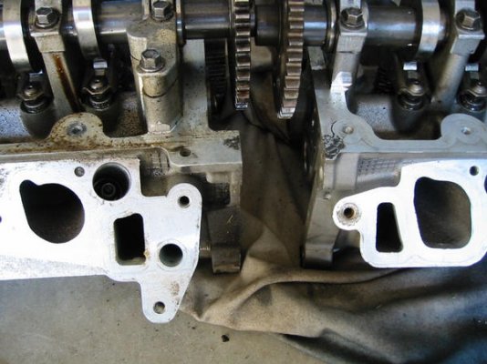

On mine, I tried to replace #7 and could not budge it with hand tools. Is there a proven procedure to loosen them? Also how can I tell if mine has PI heads?
If your motor is an '01 motor it would have PI heads. If you want to confirm it, look with a flashlight and mirror just above the front exhaust bolt and you should see the head's part number and a PI under the part number.
Early heads on the left ....... PI improved heads on the right.....
