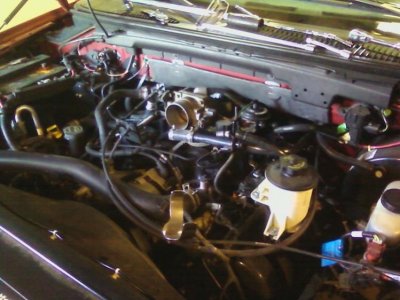

Tackled it!

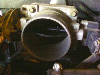

Got it done today! Took about three hours to do. I did pull the fuel rails and it made all the difference for me. I also cleaned the MAF and TB while it was open. The MAF was easy as it was exposed on the K&N elbow. The TB took a little spray and sit time until it was clean. I was surprised at how dirty it was behind the butterfly. My son helped and that really sped things up LOL.He loves dirt and grime, so he spent his time pulling the throttle cable to look at the ugly mess in the TB.
I also changed one 02 sensor, the forward on the driver side. I have the other forward but did not put it in yet. The one I did install had a different notch configuration on the plug. It is an OE motorcraft part but is not the same number. It has not thown a code yet, so if it works OK, then I will install the other too. I also managed to get a flowmaster 70 installed and did a "resonator remove" mod while I had the welder out. Total time was six hours.
This thing runs better than new now. Thanks for the tips and ecouragment!!!
