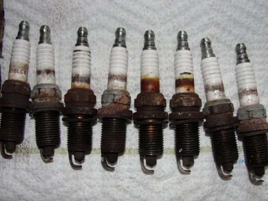

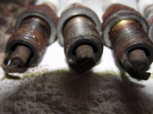

Check out these bad boys, from a 99 Durango 5.2. The dealership owners wife was the prior owner, I was assured that it was very well maintained. A couple months after purchasing and it was slow to start, found this beautiful sight.

Bain those Durango plugs were Champions. So they could've been changed that year and still looked like that .... :cheers:
Ha, are they that bad? I can't say for sure, it's been too long, but I think I stuck Champions back in it per some Chyrsler forum. We sold the Durango back around 2010, it was great to us save for burning a little more than a quart of oil every 1,000 miles.

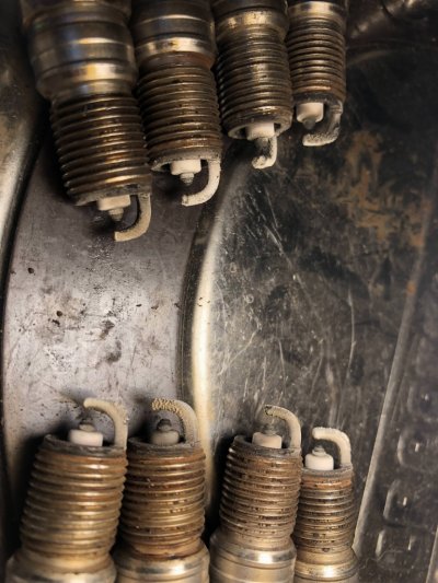

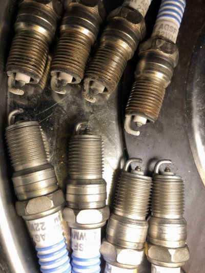

Well, the plugs were in pretty good shape and probably could've lasted the remaining life of the motor (or frame, whichever fails first on my salt & gravel road expy). However I'm glad I changed them, the #3 plug on the passenger side was loose and might've ejected itself eventually. The worst gap was 56-57, which is pretty good versus the 54 original.
At least now I know the plug history.
Old pass side vs new:
All 8 old plugs:
