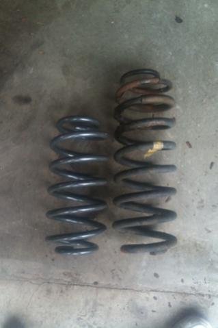

i have a 3/4 drop and thats pretty much pushing it for DD, there are a few dips on the hwy where my axle hits frame in the rear.

i dropped mine with a 3" kit from canuck motorsports, overall ride height actually came down 5". i can agree with ydopen about hitting the frame on bumps, except i tend to hit the control arms in the front off the frame rather than the rear. but it seems like anywhere around 4ish" is when you'll start running into issues on these trucks with hitting the frame

I have the Cannuck kit as well and I get the same hitting in the front. Below that your gonna need to bag it.

I have the rear bump stop completly removed, I ordered some flat polyuretane bumpstops of ebay and hope they have the same thread as the bolt that holds in the stock ones?
