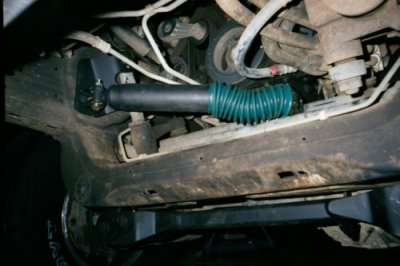

Here, this picture should answer all of your questions. yes, that is the Rancho stabilizer kit. My brackets and strut are black because I painted them that way.
In short, when figuring out where on the cross bar for the steering to put the other end, figure out where the center of travel is for the strut and then with the strut in that position, figure out where it touches the steering with the wheels facing straight ahead.
The other option is to turn the wheels to full left lock and then mount the pad on the steering cross bar near full travel of the strut. Either way works.

Awesome thanks for that picture it definitely helped a lot. I was actually missing the bracket kit which is why I was so confused.. I'm going to have to go buy that now. I had actually called rancho friday and left a message they called me back first thing this morning and the guy was really helpful. They sent me some directions through email and he gave me the part number for the kit.. Should be fine after that. Thanks again
