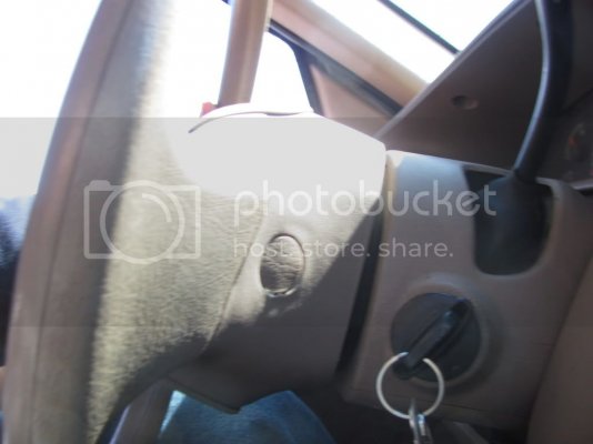

2. There are 2 round plugs on each side of the steering wheel that have to be removed.
3. Remove the 2 bolts that are under the caps. They take an 8mm socket with extension.

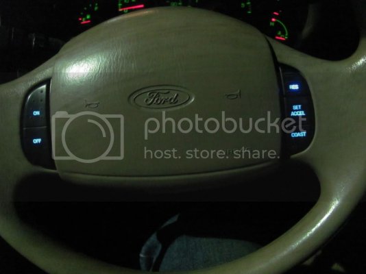

When I got it wired up, all of the lights will turn on. The top right button has a hot stop, but I think with an extra resistor, I can dim it down.
It works fine with the lights on, and I am not to concerned about it. What I have to figure out, is that when I turn the key to ON, the right side turns on even with the lights on, but all of them are off when the key is OFF. Also, if I push the ON button for the cruise control, the right side lights up again. Again, I'm not terribly concerned about these since the lights are not on when the truck is off, but something I would like to figure out so that everything works perfectly. I will just have to do some more playing with it to get it right, but if someone has a wiring diagram it would be very helpful. I will get better pictures up when I get the task finished.
