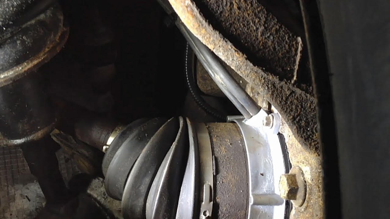

I have 2012, heavy snow here in OH this winter, so I used the 4 Auto quite a bit. Anyway, now that it's back in 2H - I notice a strange intermittent rattle noise that lasts about 3-4 seconds then goes away. Sounds like it comes from the front left side. Usually under light acceleration, 1400-1600 RPM only. You don't hear it when under load or during quick acceleration. I have taken to mechanic 2 x and they cannot make the sound appear when they test drive. Frustrating. Ideas?

Check out this video, it could be a few things. Most simple items are a $10 vacuum check valve or $20 vacuum solenoid.

IWEs are trying to engage still. Probably have vacuum leak somewhere. That’s why you shouldnt ride around in 4A
