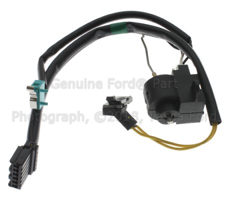

There's an access hole in the bottom trim piece that you can stick your finger in and unlock the shifter. The shift interlock solenoid itself ( 5L1Z3Z719AA ) is about $300 . Or you can check for functionality with it removed.
Shift Interlock Solenoid Assembly on eBay
