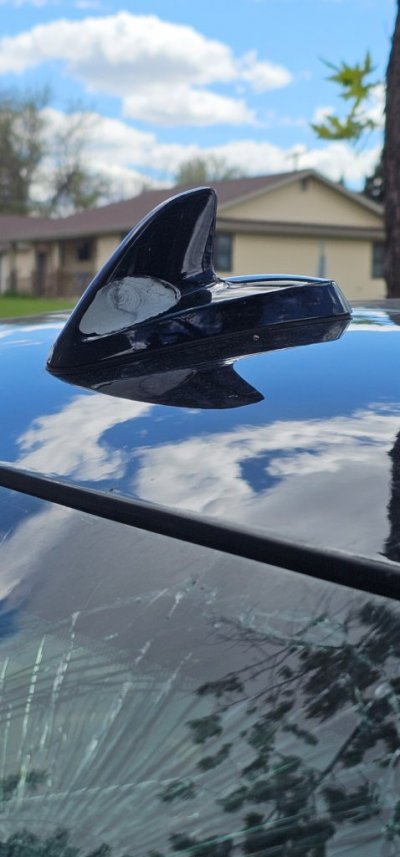

Stupid Branch - Is there a quick and cheap way to fix this antenna cover? Was quoted 900 to replace (without paint)
srvman
Jun 5, 2024
Montana
My deductible is $1000, so at this stage, its a wash - I can't believe its going to essentially cost me a grand to repair this - is there any way to either just stick a cover over the top, or is the install super complicated?
Appreciate any help I can get.

Looks like you need a windshield too, but I don't see covers available just the antenna as a whole unit which seem to range from $65-100. I'm guessing the cost is in the labor. I wonder if you could reach the fasteners through the hole that the ceiling console mounts in?

Yeah - window got smashed but that has already been fixed. They quoted 100 for the part, but best part of a grand for everything else - just fail to see how it is that much labor - that being said - I still get shivers on the last time I replaced a moonroof in my f150

OP, depending on how handy you are.. you could sand the edges of the paint loss and then use spray paint or vinyl wrap. Assuming it still functions.

As far as the OP’s original question yes, it is a lot of labor to replace that antenna. The A, B, C & D pillars trim all has to be removed and the headliner taken out of the vehicle. I can see this being a several hour job. If you do it and break something you might end up paying more. If the deal ship breaks something and you can find it they pay. Is your insurance not covering that?

i was absolutely thinking about some kind of vinyl wrap. just make sure the paint is done peeling. that is if the antenna is working. its plastic so you don't have to worry about rust or anything like that. Someone should bust out a 3d printer and make a cover that just uses double sided tape.
