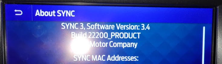

21194 Is not known to have any issues, but yes there are newer. Inventory of a drive full of files, yes can slow Sync down for a while especially if it is a slow drive. If you removed it rebooted Sync, and it was still slow, then that is not the cause. I suggest connecting to WiFi, and checking for updates.

Upgraded to a newer SYNC version, will keep everyone informed. For now, I can at least say that I feel it handles my 8900+ MP3s on the USB drive better. It did hang for a few minutes, but eventually recovered. Buttons to skip songs didnt react immediately, and sometimes the song did change but the display did not reflect the change.
