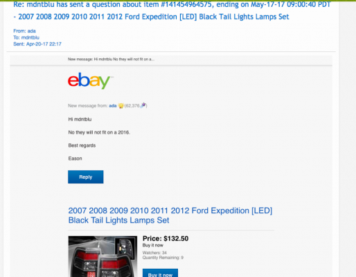

It's kinda random that not a single website or Amazon listing or eBay Listing says that 14-17 will work with the 07-12 tail lights.
I even emailed a few eBay sellers and they replied and said they will not work on a 16. Thoughts?

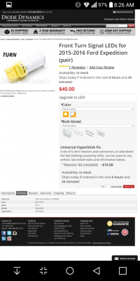

I've been looking at the LED tail lights but honestly what I don't like about them is the LED panels don't look like they provide much side view. They seem too close to the back of the lens to give any side view light. The installation instructions say that you use your bulb sockets and connect them to the tail light pigtails that they provide. It essentially looks the the end of the bulb with wires going into the tail lights to power the LEDs, you still have to use your incandescent backup bulb.
I'm seriously considering just replacing the bulbs with LEDs but I am concerned about getting the hyperflashing issue. I know that you can change the flasher unit but I haven't figured out what I need if any.

I've been looking at the LED tail lights but honestly what I don't like about them is the LED panels don't look like the provide much side view, they seem too close to the back of the lens. The installation instructions say that you use your bulb sockets and connect them to the taillight pigtails that they provide. It essentially looks the the end of the bulb with wires going into the tail lights to power the LEDs, you still have to use your incandescent backup bulb.
Check out diode dynamics if you do decide to go with bulbs. I'm actually thinking about building my own led panels to retro into these but haven't had much time to get stock together.

Hi Andy,
Keep in mind that on 2012 and newer Expys that you can't change the turn signal flasher relay to fix hyperflashing. there isn't one. It's current sense on the blinkers is controlled by the SMB and not adjustable (to my knowledge.) I ran into that on my '12 and ended up putting in the resistors.
