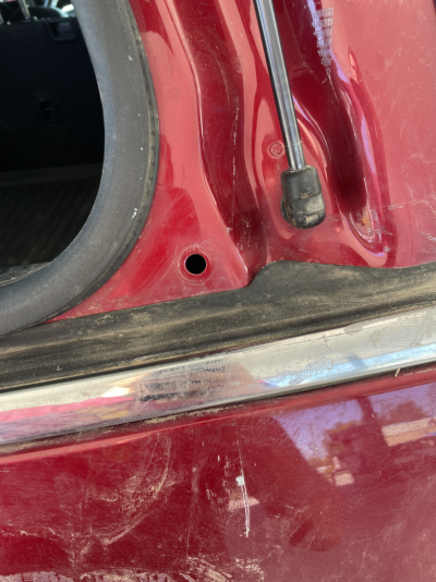

I had my rear window smashed at a trailhead a few weeks ago and replaced yesterday. Just now I noticed that they did a pretty poor job centering the new window leaving me with a gap on the passenger side and contact with the black facia on the driver side. I also noticed these two holes on either side of the glass and am wondering if when I take it back to be aligned I should be having them install bumpers that may have been removed. Does anyone else have these holes to either side of their rear hatch?

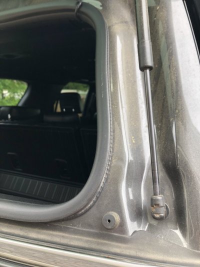

Some installers remove them when their replacement glass fits sloppy. You should find a pair, put them back and adjust the glass properly.

Can probably go by the dealer parts department and pick up a few. They're only a few bucks apiece. The repair shop will just say they weren't there when you brought it in.
Should be part number: Ford W719758-S300

Same here. Two bumpers. Probably only the second time mine was ever opened.
It should not be your responsibility to buy new bumpers or do a "re-adjustment," that should be on the place that was paid to do the job. If this was an insurance claim and your insurance company recommended them, let your insurance company know the quality of workmanship they are recommending.
