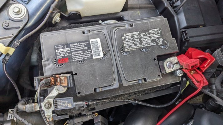

hmmm. battery store ran a test on the battery using a carbon pile 100A tester, said the battery has about 750 CCA left out of its original 800, and as far as they can tell, its fine, but its voltage was a little low. I started the engine, they saw 14.x V at the batt so it seems like the alternator is working. they suggested hooking up a charger, so hooked up my NOCO Genius 10 in AGM mode.... charger declared battery full after a hour or so... I've found my cigar plug volt meter so I can watch the batttery while driving to see whats going on.

I notice you attached the negative charging lead directly to the negative battery terminal. I am let to believe the correct way is to attach this lead to the bracket of the battery status monitor (the black component in front of terminal) This way the system update’s itself to the new charging level. YouTube has more info , check it out , think it’s Makuloco

Yeah, I realized that looking at the picture.
Anyways, was scared seeing 11.9 or less volts the morning after a full charge so I put a new battery Tuesday. ... I stumbled around trying to figure out how to do the battery reset, and found a page in the owners manual saying that sitting off for at least 8 hours will cause the BMS to learn the new battery, no fancy reset required.
