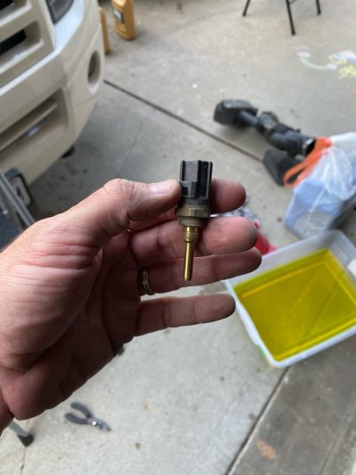

Finally got it out. And yes, that is anti-freeze not urine. Lol
Hopefully a new one will do the trick
