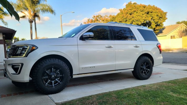

For anyone looking for what this setup will look like here you go.
Well, they fit! Stock, no rubbing, and no fuss.
Specs: Wheels are Fuel Coupler D556 18x9 +19 offset. Tires are 275/70/18 KO2s.
Truck: 2018 Expedition Platinum 4x4.

Was there ever any doubt? Now go post some more pics in the big tire thread.

They are not noisy at all K02 are quite and they legit have saved us off roading in deep mud and snow now. I would never go back to 20s, not my style. We are always up for adventures off the road.
