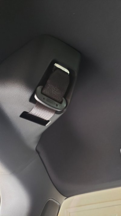

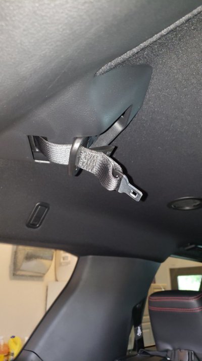

This drives me crazy!! And I see it on others driving down the road. It seems that the magnet is not strong enough and it slides down pulling the buckle out of it's slot. Has anyone come up with a fix?

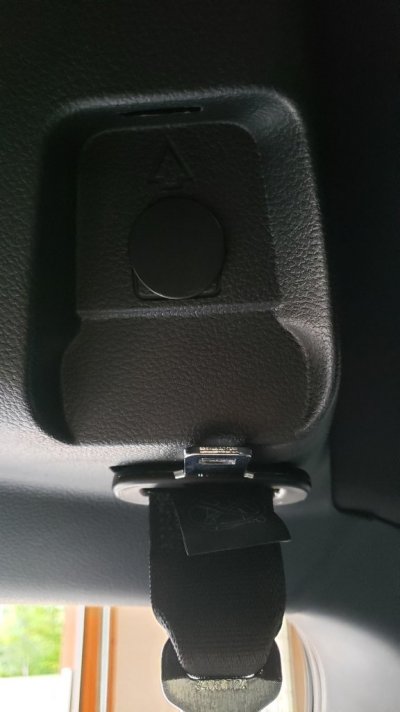

Got the magnets. Damn are they strong. I used one and stuck it to the magnet that was there and now the buckle sticks to the new one. See pics. Time will tell if it stays now.20210904_144112.jpg

So far so good with it staying put with the stronger magnet.
