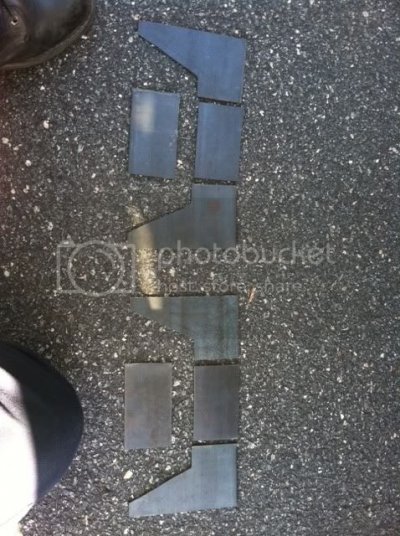

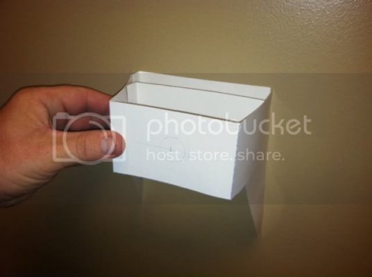

I used some posterboard and got all the measurements and made a bracket. then took all the pieces and traced them onto the steel and cut the peices, the side pieces flare out from the front to the frame, in other words the brackets width is wider at the back where it mounts to the frame of the truck than it is at the front. I will make a "jig" out of wood to simulate that angle as well as the depth between the front piece of steel and the next piece in that the shock will mount between

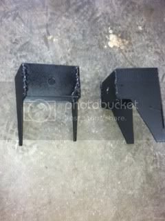

Here is what I came up with, I had them all welded together then drilled the hole that the shock bolt will go through then primed and coated with that Rustoleum bed liner
For some reason in the pic they look lop sided but they are straight- bad camera angle
