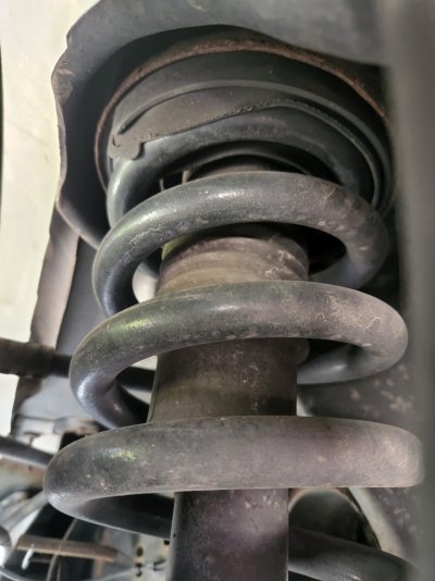

Can you post a pic of one of the shocks?

I can get a pic here shortly. Honestly, I really like my navigator but I've come to see all the bull hockey fixes the dealership I bought it from did to make it look presentable. I'm worried that if I hook it up, something will go terribly wrong. All the dealers here in my area are covered up (some will not see new customers) and I don't want to end up really bad off.

Ha! Jokes on me, that doesn't look like air suspension at all. Sorry for the delay, it rained all afternoon yesterday. This does look kind of like the strutmaster kit (maybe really old) safe to just put some bilsteins
