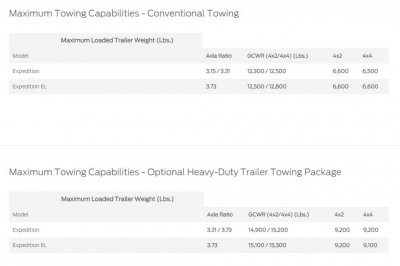

Welcome to the forum Nate.
If you PM me with the VIN I will run it through ETIS and give you the As Built specs for that vehicle.
I have a 2017 Limited with the HD Tow Package and my tow capacity is 9,000 LBS because I have the EL version. 9,100 for the Std Wheel Base.

@NateO if you give me the VIN I can look it up. It’s possible a rental company got a limited WITHOUT tow but highly unlikely.
Also I believe 6600 is the max towing without a weight distributing hitch. Without the HD towing I think the capacity is 6000 even. I could be wrong.

Nobody seems to be mentioning that the 9,000lb + capacity requires a weight distributing hitch, right?
I believe my 2011 Expy Ltd with tow package was rated for 5,000lb and 8,200 with WDH. My newer 2017 is rated for 9,200 with the WDH.
6,530
3,140
Correct, your 2011 was rated at 9,200 pounds with the WD hitch though not 8,200.

After reading this thread, I may not have gotten the deal I thought. Couple of questions. Does the HD tow package change the towing capacity of the Expy? ETIS says my truck has a trailer tow prep pack. What is that? Finally I crawled my fat rear end under truck. Hitch says 9200lbs wdh. Does that mean I can tow up to 9200lbs as long as I am using a weight distribution hitch? It says it comes with Trailer sway control. Where would I find that at? How difficult is it to install that round pluggy thing?
Sent from my Pixel 2 XL using Tapatalk
chuck s
Dec 20, 2006
1,990
753
To my knowledge the 9200 pound capacity receiver on the truck is only fitted with the HD tow option. It's the capacity with a WDH. There's a different receiver of less capacity (6600 pounds?) for the non-HD tow trucks. It's also my impression that the round, 7-pole Bargman electrical connector is only fitted with HD Tow.
Trailer brake controller is fitted to late model trucks. Earlier trucks have a connector under the dashboard allowing easy connection to a good controller like Tekonsha Prodigy.
Trailer sway control seems to be part of HD Tow.
The standard Expedition and standard Navigator differ slightly. With HD Tow, though they're set up the same.
(Both my '07 and '17 trucks had HD tow.)
Highly recommend you download the Ford Trailer Towing guide for your model year. Just google it with the year. Has all this info on what equipment is in the packages.
-- Chuck

While Heavy Duty Trailer Tow is available as a standalone option on XLT, according to the Ford sales brochure it is standard on Limited, King Ranch, and Platinum for 2015-17. It is also included in Equipment Group 202A on XLT. So, if the XLT you are looking at has heated and cooled front seats, it should also have Heavy Duty Trailer Tow. Hope that helps!
