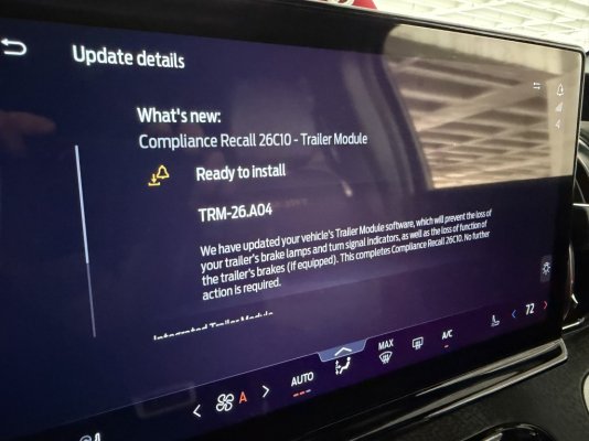

Ford so funny. Says "Ready to install" and then you have to read the "fine print" to learn that "No further action is required."
Thanks for posting--I will look for it.
