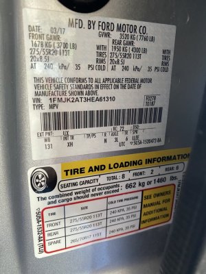

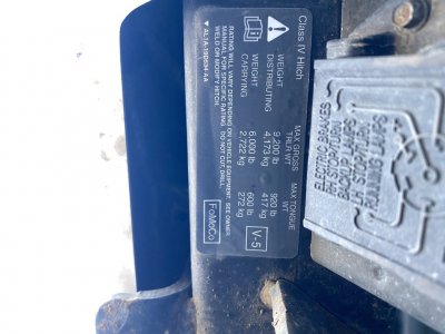

2017. Don’t believe has tow package. Manual says 9200 with stab hitch and a 920 hitch weight.
6,530
3,140
Slow down their friend. 9,200 pounds is with no gear or people in the truck. Take a look at your payload sticker, notice it says 1460 pounds. Take 920 pounds off that and that leaves you with 500 pounds left. Assuming you’re a 200 pound dude that only leaves you with 300 pounds left. Is it just you and one other person and no gear in the Expedition? If you have any kids or dogs/gear with you it’s going to max out the truck or go over and you’ll be doing some white knuckle driving.

It usually the payload number that really limits you with the Expy. 9200 tow rating is very nice, but if your payload capacity isn't up to ***** then it really affects how the set up rides.
Jason's sticker says 1460lb max payload, but my Expy is only 1402lb, I imagine because it's Eddie Bauer version, perhaps more options, usually means less payload.

If you don't have a Heavy Duty Tow your max is closer to 6,000. There seems to be fewer HD tow Expeditions out there on the market. When I looked it was mostly Limited trims that had HD tow. Your target trailer size should be 70% tow capacity of the truck. So 70% of 6000 lbs or 9200.
