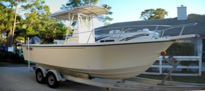

How much are you planning on towing and how often? Generally factory ratings have some conservatism in them. If you are towing at or near the rating infrequently, I would not worry about extra cooling unless you've actually tried it out and seen where you cannot maintain the normal temperature. I have your same vehicle (1 year newer) - I have not done any mods and do not have the tow package. I did retrofit the 7 pin and have a Class III hitch. I tow a boat that ranges in weight from 5500# to perhaps 7500# when fully loaded (rarely towed in that configuration). Almost all trips are local at slow speeds so that moderates the load per se. I only go distance once or twice a year where I travel 225 miles to the Fl. Keys. In that configuration where both the boat and trailer are near the tow package capacity (lower actually), I simply go at slower speeds, monitor everything closely and leave plenty of room to brake (I have trailer brakes).
I'm sure there are folks out on the forum that will say I'm a mad man, however the ratings are generally listed for continuous load at those max conditions, max outside temperature, etc. etc. That's what we engineers do when we design things.
I've been doing this for 4 years now with no issues (not necessarily enough data for the tranny temps), however my car never heats up above the normal temp. Trust me - the temps to the Keys in July are up there!
