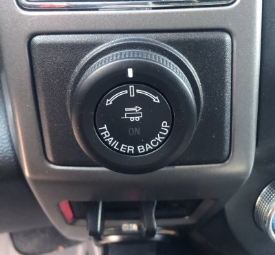

In that case, the pro trailer backup knob would be a better indicator. 369315DD-1CC6-4FBE-B322-AD716CF1B198.jpeg

In that case, the pro trailer backup knob would be a better indicator. View attachment 36040
Since the F150 guys have figured out how to add the pro trailer if one was feeling adventurous I would think that it could be done to the Expedition.

The knob was the easiest way for me to look at online vehicles for sale, or locked vehicles on the dealers lots after hours. Its just quick and easy to look quick.
This is what I was getting at, if there is not brake controller, or back up assist, you don't have the HD tow. Just another quick way to make an assessment. I did a lot of internet searching too and it was easy to know if it was worth going to look at.
