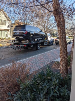

This is exactly what took them 3 weeks to figure out when I took it in. After they supposedly fixed this issue at 9k miles my Expedition is back in the shop as we speak because something popped while driving this past weekend and transmission fluid started leaking all over the place. Had to get ford to tow this POS back to their location and we are now 4 days out and they still don't know whats wrong. Currently in the process of getting estimates to off load this thing before the it costs me a fortune. Kills me I've put 2gs into tires and powder coating wheels only to dump it.^^^Sounds like what mine did when a snap ring in the transmission came off. They rebuilt mine
