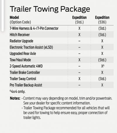

Just remember the 10R80 uses a heat exchanger to cool the oil. The tow package give you a larger radiator to help with the heat exchange. The Raptor has an air to oil cooler and I have been trying to find out if it can be retro fitted to the Expy. I haven’t had the time to go to the dealership and look up the parts.
I think all they are trying to say is that it is the same as the standard. For example the hitch receiver is not upgraded for the 536 package.nope, that doesn't follow its own rules.
if that were the case, then why the X in the Std. Expedition column? I think they may have meant what you said, but they were at least inconsistent about the application.
Makes me wonder about what else they might have F'd up.
