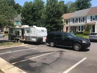

Towing a 2018 forest river Salem 26Tbud. 6100lbs dry and using a standard WDH and sway bar attachment. I have the heavy tow package as well and it pulls great!!! Really impressed with the expedition! Monday will be installing 285/70 r17 e rated tires on raptor rims than next is getting tow mirrors

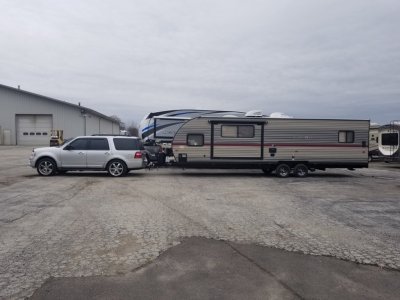

Hey hey hey, my 08 Explorer tows like a damn champ. I did just upgrade to a 2015 limited expedition, and looking forward to towing in the spring with it. We have a 2016 Tracer 270air, its around the 7k mark full loaded.(which is at the top rating for the explorer). The biggest part of my success is the Equalizer WD hitch, it's the only WD hitch I've owned and I never looked back! Also the explorer has adjustable Rancho shocks that are great as well.

I believe that year explorer is still on a solid frame the newer ones are on a unibody.

Yes, that's correct it's a body on frame. I'm happy that I will have a good basis for if towing is better or not. I'm hoping that setting up the suspension with the Equalizer isn't too big of an issue. I was surprised to see that my expedition has the select-able suspension with the 22" wheel package and HD towing package. As when I was building them on ford's website if you selected the 22" rims that it take the load leveling suspension off as an option.
