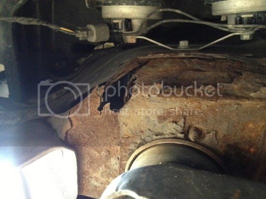

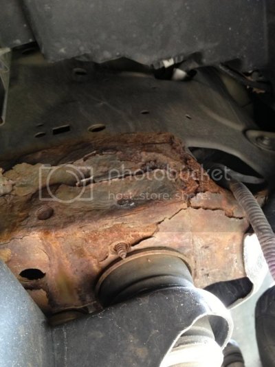

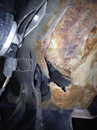

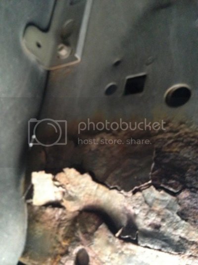

Just rolled underneath my expedition to check out my support mounts. And they appear as bad or worse visibly than yours was. What would you recommend me doing? Do you think it's safe to continue driving like this for a while because I don't have the money at this point in time to get it repaired correctly. Was there welding involved in this job or is it a "bolt" on job? Because if there's no welding I might feel confident enough in attempting it on my own.
Sorry to hear of your findings.
. Post up a few pictures of the damages if you can? The "before" pictures of my truck are from 7 months ago when I bought it.. I probably could have driven it for a lot longer and maybe never had an issue.... But when you look at what that support does, it is an important part of of the truck.
Unfortunately, the old support needs to be removed by drilling out all of the factory spot welds, and the new one needs to be welded back in is place. The frame then bolts back through the new support using the big bolts, rubber isolators, etc.
My mechanic said that when it does let go, I would know, because the front end would make noise on bumps, etc...
Looking forward to seeing pics of the damages you are working with.
