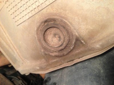

Hmm the only thing I can see that would possibly be for drainage is this right here: (see below pic.) I don't think that's it. Anyone else know if the TC can be drained separately? Also, what is that circular piece in the pic?

That just looks like an access hole on the bell housing. Should be a rubber plug. If the converter has a drain plug it would be right on it somewhere around the circumference or outside edge.

^^ yeah, that's the access hole alright. t/c may or may not have a drain plug. Check 360 degrees around it and you can turn the motor manually to line the plug up with that hole
