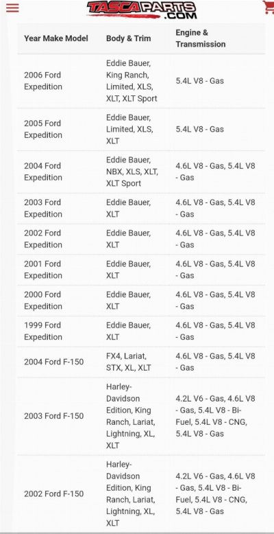

Also, what year an engine size? Though, it shouldn't matter. According to Tasca parts, the purge valve is the same for 4.6 and 5.3, 1999-2006
Base part number is 9c915.
I would start by performing a vacuum hold test.
Disconnect the the engine size vacuum line and use a brake bleeder pump with a Guage.
