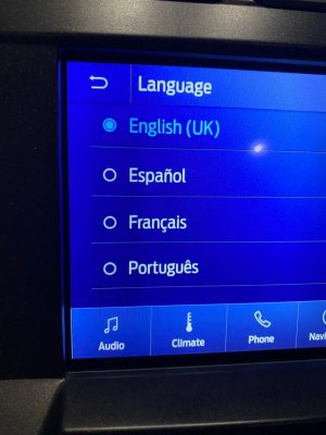

Just installed this (on my '18 Raptor) the only language options are English(UK), Espanol, French or Portugues? Where is American English?
I have done 2 hard resets..
I haven’t done the switch yet. Just a thought. Did you accidentally install the European version?
mmayo
Sep 17, 2019
Don't believe so, map/gps is working for here in the US and i don't believe we can install the European version on our APMI due to lack of harddrive space.
mmayo
Sep 17, 2019
Figured out the issue. I had my APIM changed via forscan to where i could input Nav while driving. This is done by changing the region to UK. Side note, this disables sync's ability to call 911 when the airbags deploy.
