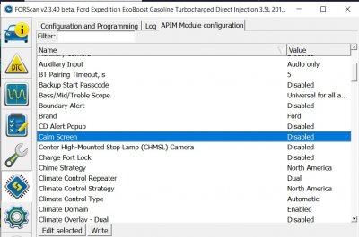

mmayo
Sep 17, 2019
Figured out the issue. I had my APIM changed via forscan to where i could input Nav while driving. This is done by changing the region to UK. Side note, this disables sync's ability to call 911 when the airbags deploy.
