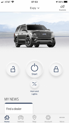

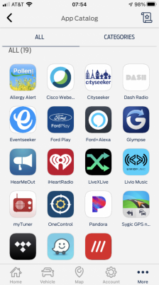

Post a day using Sync build 3.4.21098, it is noticeability faster navigating from menu 2 menu or screen to screen. Almost instant response now. I also have more apps available on the sync screen/CarPlay (Dunkin Donuts & Cisco WebEx were the ones I noticed as new so far).
Webex has been CarPlay capable for a while. They removed it in last revision, cause it was buggy. They apparently added support back in the most recent.

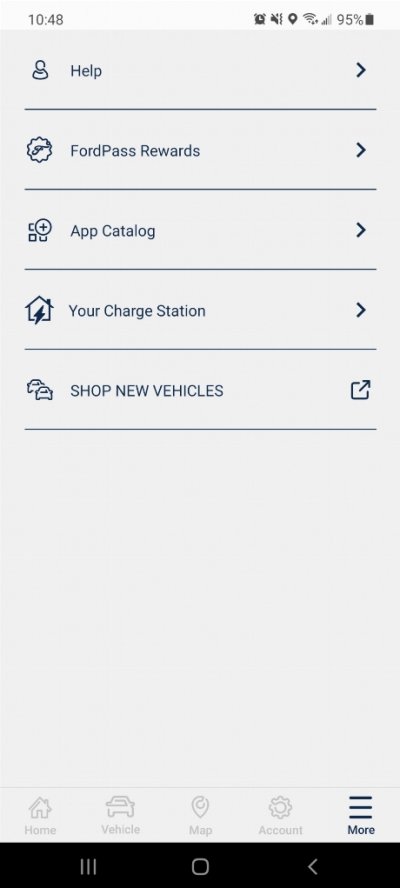

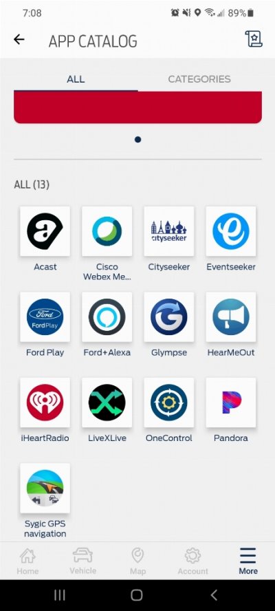

US
Thanks. Looks like you have an iPhone. Here's what I see in Android 11 for the same version of Sync.

49735
What changes do you see in Ford Pass and what are the settings to get the Google Assistant to work without Android Auto enabled? Do the newer Expeditions support wireless AA?
In the Phone settings menu there is now a button for Voice Assistant. You can specify either Google or Alexa. A long press of the VR button on the steering wheel will bring it up.
