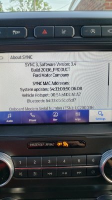

Mine came from the factory with 3.4. Build 20136.

I started with 3.4, build 20136. I now have 3.4, build 21020. It hasn't stopped updating though. So far I have three downloaded and three installs. There is a 4th that is in process but it will have to wait until my wife gets back home so it can continue once it connects back up to my home wifi.
The SXM GUI changes to now have the album art. Also, the terrestrial radio GUI updated and there is a image where the album art would be but it isn't working. Also, after the third download and install the maps updated to NA 220 (I think). I'll post pics of the version info once it's all done.

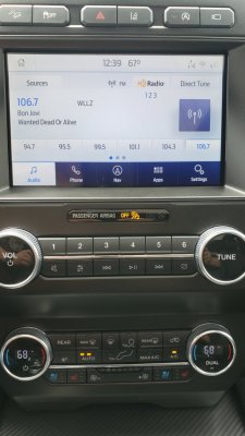

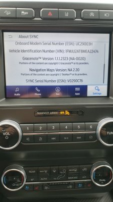

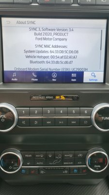

Well well... It's done. All total 8-10 files it downloaded. I tried to keep track but I'm sure I missed one or two. No more than 10 though.
Here is the current SW version info:

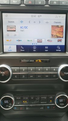

Album art is working for SXM
But not for terrestrial radio.
Kinda bummed they changed the GUI for the radio stations and now no image shows up. It used to have the stations logo. Now nothing.
Looks like was some changes to Ford Pass and now Google assistant works without having to plug in USB and launch Android Auto.

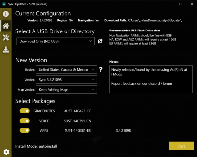

Post a day using Sync build 3.4.21098, it is noticeability faster navigating from menu 2 menu or screen to screen. Almost instant response now. I also have more apps available on the sync screen/CarPlay (Dunkin Donuts & Cisco WebEx were the ones I noticed as new so far).
