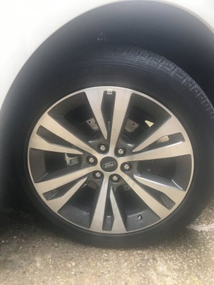

I went with the PowerStop Z23 Pads all around + drilled & slotted rotors in front. Been running this combo on Expys for 12 years with great performance per cost. The hotter you get the pads, the, the more they bite with no fade coming down Pikes Peak or towing.PowerStop.jpg
