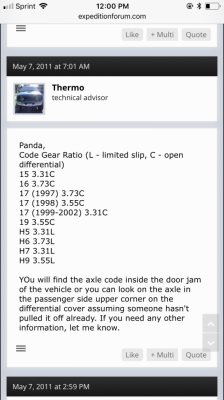

Rear Axle Code on your door jamb sticker. You can look up the letter bank. C is open diff L is LSD after your gear ratio. Heres the breakdown on decoding it.
