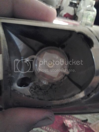

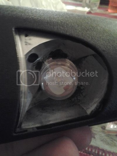

so i scrambled myself to get some LED lights, cut tru the wirings removed the now charred socket and installed the new LED
it fits perfectly and after a little modification i got it to stay put firmly in the casing.
here is another pic

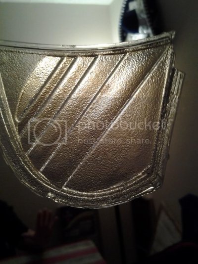

now i had to clean and restore the plastic lens because all the heat had made it yellow, so after a good scrub-down with soap and toothpaste( basically rubbing compound) to remove most of the heat damage i applied some clear NAIL POLISH ( yes being married has its advantages hehehe) to restore clarity and give it some protection to the plastic.
here the pic of the final result
and here the before NAIL POLISH application

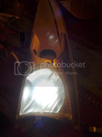

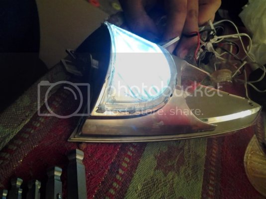

ok then i move to test the LED brightness
without the plastic cover
with the new savaged plastic cover

ooooppps i just realized i took both picture with the plastic cover hehehe i guess wine plays tricks on me sometime hehehe

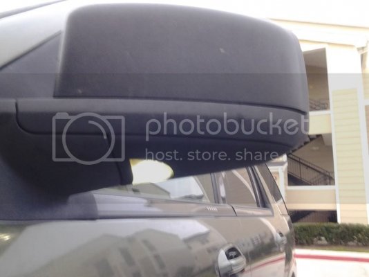

ok guys here's the finished product...
day shot
night shot
im very pleased with the brightness of them and it gives the truck a luxury look.
