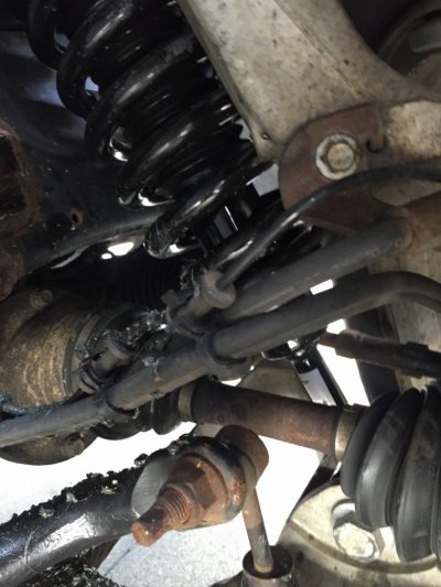

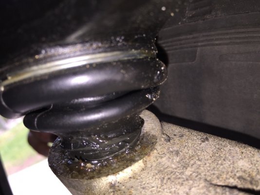

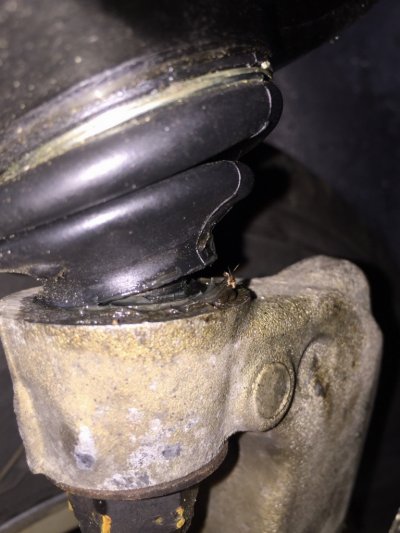

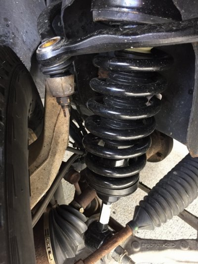

Hey guys, so just got done everything with leveling my truck and ran into an issue...
So you know here's what I put on:
New complete struts all around
New sway bar end link
New tie rod end
New upper control arm+ball joints
Had the small issued I had worked out and it was aligned last Friday think 5/6/16... Anyways I drove it for a few days now and when I got out to check everything today after work the New control arm/ball joint I got from NAPA on the passenger side has failed...
It failed in the sense that the rubber housing around the joint came up a bit and exposed the insides and that grey grease poured out everywhere on the suspension... The shops all day they give me free labor and alignment and napa says they'll replace it again but why does this happen? And is napa not selling a quality part? Or is this mainly because of the leveling kit? Or should I be buying a different arm/joint that's more "heavy duty"?
If anyone can chime in its greatly appreciated so I don't keep running into this problem over and over... Also the new arm and joint will be put on tomorrow and alignment in afternoon...
Thanks guys
Edit: Figured I'd attach some pics so you can see what I mean...
bc75ef87f6e21224fd5788011d95c219.jpg12b70f554c7ff7a1b4de9eed45bebe7c.jpg7a1694fdb0172214570978f91315375e.jpg

Yeah I'm getting a whole new arm free from Napa and my mechanic is going to out it on for me again for free and then it's going to alignment for free but I just don't want it to happen again you know? Lol

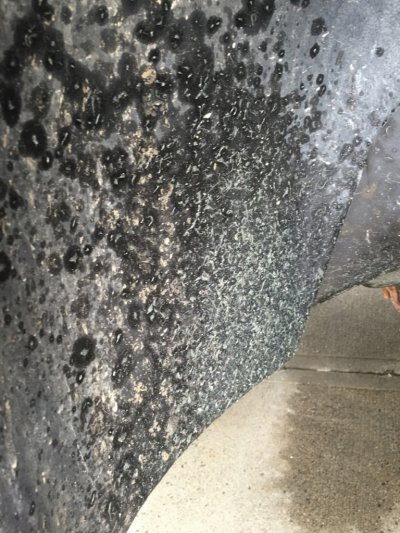

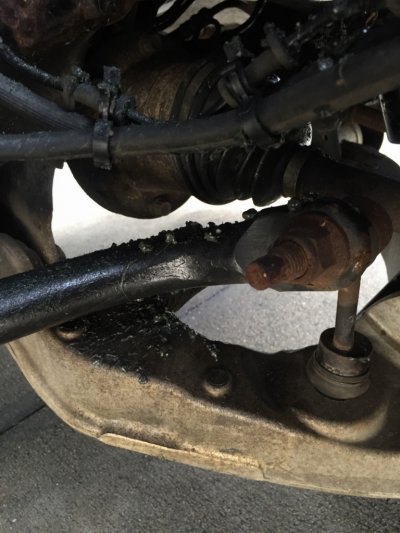

So the when the upper ball joint boot separated this is the grease I found poured out everywhere... Don't know how all this grease was in there but....

How's your front CV boots ? 'Cause that grease quantity and pattern look like a split or torn front CV joint boot, not a simple leaking upper ball joint boot.

The cv boots appear fine they do need replacing in my opinion... That's what I was thinking when I saw that amount of grease as well but they look ok... When I get the new arms in and get it aligned I'll check the cvs again
