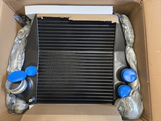

So with my 93 performance tune I saw IAT2 temps exceeding 140 degrees with ambient in the mid 90s and IAT1 around 105. The peak of summer hasn't hit yet here yet in the gulf coast region, so I decided to spring for an intercooler upgrade. I went with the Wagner because they specialize in this hardware and their part is supposed to be a drop-in preplacement. Here is a pic for those interested. I was going to post a size comparison but figured there was a better one available.

I had to change my oil, so I figured I would finally tackle this as well. I was getting tired of the box taking up floor space. Regarding installation, the only thing holding the intercooler up is the bottom support bracket, so no need to mess with the grill or bumper. The lower air dam should be removed, as it gets in the way. The stock intercooler has a shroud that wraps around the upper support bracket, so that needs to be pushed over the upper bracket.
Apart from the above, the Wagner is a drop-in part. Just disconnect the the charge air hoses, cool side hose, recirculating solenoid line, and the solenoid electrical connector. After that it drops out. Install is reverse of installation, but connect the cool side hose before the recirc line because that valve has to be rotated into position. A helper is recommended, as the Wagner is much heavier. My daughter jacked it up using my floor jack while I maneuvered it into place.
I took it for a short test drive around the block and all I can say is wowza. I already have a 93 performance tune. I didn't expect much from the intercooler apart from lower intake temps, but there's definitely a noticeable improvement. It was comparatively cool outside, but the IAT sensor was reading around 95. The increase in IAT2 was limited to around 25 degrees, as compared with 30+ to 50 degrees on the stock intercooler. This one also doesn't heat soak nearly as badly. It got hot after romping on it, but cooled down nearly immediately once the vehicle began moving. I think there must be some flow improvement as well, because throttle response also improved. Strangely enough, I also saw up to 21 psi, where I was maxing at 18 psi before.
In conclusion, definitely a worthwhile upgrade, especially if you're already running a hotter tune.
