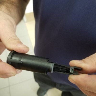

Front camera nozzle was leaking and had it replaced today. I asked to see the old one and nothing visible indicating the cause. There's quite a bit of tension and is spring loaded. The seal or O-ring inside must be the culprit. I'll check in the morning if any fluid has leaked overnight.
